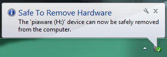

Windows
  1. Once the file has been edited save and close Notepad
  2. Eject the Micro SD card either in My Computer by right clicking and selecting Eject or in the system tray.
  3. piaware eject Windows 7
  4. A pop-up should appear stating it is OK to remove the SD card
  5. Windows SD card safe to remove
